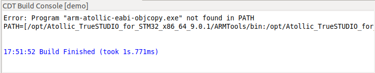

The TrueStudio project generated by STM32CubeMX fails with the following error:
Build success after performing the following steps:
1. go to ''Build Settings...''
2. rename ''arm-atollic-eabi-objcopy.exe'' command with ''arm-atollic-eabi-objcopy''
3. click ''OK'' button
For more details please find attached demo.zip project generated by STM32CubeMX.
