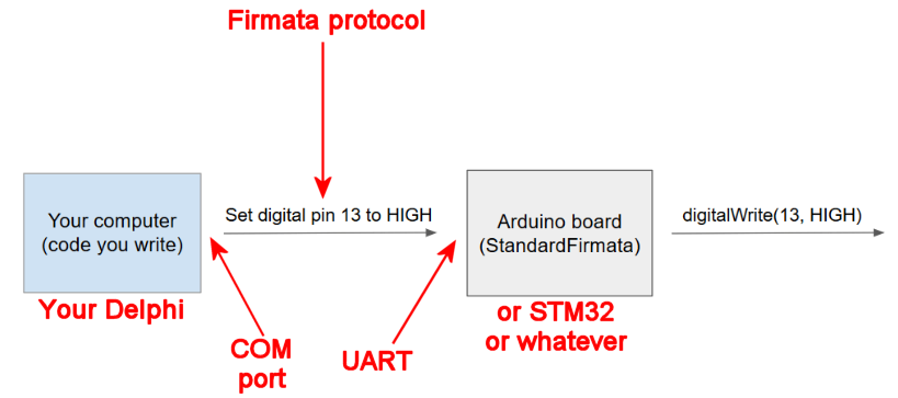

Hello All
I tried searching all over. Is there a  STM32  API for Delphi program developers. The idea is that I am Delphi programmer who would like to design custom programs to read/write to STM32F4 development boards. STM32Cube IDE is fine for running the programs on the board. I need to design a custom GUI which will run on my PC so that I could interface with the boards through the USB. I could then read the status of any sensor etc attached to the boards and manipulate the data accordingly. Any know of such an API?

Hello and thanks for the reply. You mention Firmata. How do I use this with Delphi? I am really unfamiliar with other languages. However I do know how to program Arduino. Delphi on the other hand will require some Library or component or an API (with all the commands, functions etc)
It's a communications protocol - so you'd need to implement that protocol.

The key is to remember that the Arduino or STM32 or whatever is an entirely separate hardware unit, with a comms link to your PC - so what you need is to implement the PC-side of that comms link, in accordance with the Firmata protocol specification.
Like this:
from this tutorial on using Arduino Standard Firmata:
https://roboticsbackend.com/arduino-standard-firmata-tutorial/
it includes a utility to allow you to test it without having to write any PC-side code.
The communication is over a COM port - so, if you're implementing a Client in Delphi, your Delphi will need to interact with the COM port.
