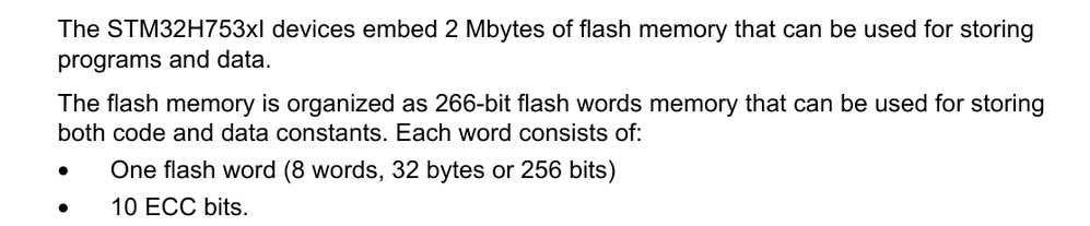

Hm, has "normal" flash;
Flash can only be erased and written, then read for verify , whether its correct; thats always this way.
on download/flash the image is verified (if you sect it in CubeProgrammer);
so what you wanna "check" ?
Some series have error detection+correction in flash , if need 100% safety always, example H7 series ->
