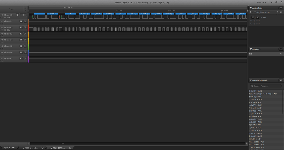

So I'm trying to read and write 64 byte long list from FT24C16A. I'm using STM32F103C8T6. So first picture displays I2C init for uC. Not problem here. I'm using 3.3 V.

The problem is, reading same send data to EEPROM. I send "0hello there, This is a test" but I read back this "0693W000001pL90QAE.jpg
I also check this with logic analyses. It's same: 0693W000001pL9FQAU.png
And I check SCL, SDA and power 3.3 Vpp ripple. Its all in good. I also try with 100kHz speed. Same result.

But funny is, when I send just "0hello there", a get correct sentence back.
Only when I send more that 16 bytes to EEPROM, I do not get correct sentence back from it.
So, what can I do here. Am I sending or reading data in wrong sequence.

>>Only when I send more that 16 bytes to EEPROM, I do not get correct sentence back from it. So, what can I do here. Am I sending or reading data in wrong sequence.
Surprisingly the Data Sheet does address the 16-byte issue/wrap
https://datasheet.lcsc.com/szlcsc/Fremont-Micro-Devices-FT24C16A-ELR-T_C232875.pdf
2 REPLIES 2
Ok, I understand now. :)
