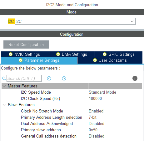

And I setup the I2C channel like this:

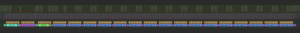

I used a logic analyser to see what is happening in the I2C line:
The chip (master) makes a write request to set the address of the memory it would like to read and the slave acknowledge it and it recives the data correctly (I saw in the debugger).
Then the chip request the data from the MCU and here is the problem, the MCU is supposed to sent the first 16 bytes from aTxBuffer but instead it send only the first one and and apparently the chip makes another read request that the logic analyser sees as data.
HAL_I2C_ErrorCallback is called right after HAL_I2C_AddrCallback is called with an OVR error.
