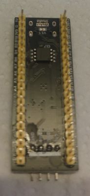

I've built some simulation pedals, which are a rotary encoder and a load cell. These are connected to the Blackpill, and the Blackpill is connected to a PC running Windows 11. The PC should detect them (I managed to do this with an Arduino Leonardo) as a gaming device.
1. show your board or link
2. I have also "black pill" boards, F401 and F411 ; cpu's are genuine STM , as on most boards.
3. The "board" doesn't have to be from STM, only the CPU on the board.
4. You have an st-link ?  Then try connect in CubeProgrammer and show, what its telling.
Then you know, it could/will work with the IDE ...debug... or there is a problem.
 V3.1 WeAct Studio
