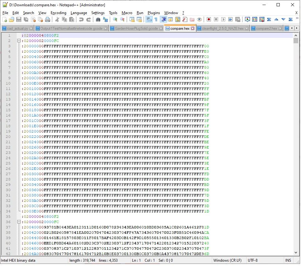

Hi - I took a new Flip32 Flight controller board out of its sealed bag and reflashed the latest clearflight firmware (cleanflight_2.5.0_NAZE.hex) using the Flash Loader Demonstrator onto the board in Boot mode. ( I also tried clearflight configurator, and STM32CubeProgrammer)
It accepted the flash hex file and I could read the contents back and they were correct. But as soon as I power cycle back to run the program, it doesnt run, and upon investigation, the contents of Page Zero(0x08000000-EFF) are all 0xFFFFFFFF
There are no option bits set that I can see that would lock this memory from reading it, and the software doesnt run.

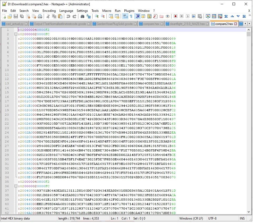

@Community member​  Yes I can view and compare the program before and after reboot at address 0x08000000
Before and after reboot:

Change the first few bytes right at 0x08000000 to 0xFF (to prevent the code from doing anything useful), then reset, and see if the entire page 0 is still reset or not.
