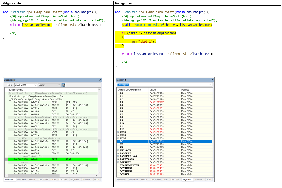

Hi support,
I am working on a project that is using uC/OS-III running on STM32H750XB using IAR with Segger J-Link debugger.
Recently we encounter a strange issue where reading a pointer (itsScanSampleAnnun) will return a wrong value intermittently. The value can be a random number and usually is an invalid address that will generate hard fault when accessing it.
Thus, I added debug code to cache the pointer value in a static variable and break when their values are different.
But, when I inspect the value of itsScanSampleAnnun in the Memory window, it is correct.
By looking at the assembly code, the pointer value of bkPtr is loaded into R2 register and the pointer value of itsScanSampleAnnun is loaded into R3 register. As you can see below, the R3 register is having a wrong value. Not sure where and how the wrong value is getting loaded into the register.
Appreciate if you can provide any advice to us. Thanks …
rgds,
kc Wong

So far, from what we have observed, the hard fault occurs when a CPU register is loaded with the wrong value while the memory has the correct value.
Our suspect now is that the CPU register loads the wrong value from the D-Cache.
Also we found an errata sheet on ST web site.
https://www.st.com/resource/en/errata_sheet/es0396-stm32h750xb-and-stm32h753xi-device-limitations-stmicroelectronics.pdf
For now, the wrong value loaded into the CPU register is most likely because of the data corruption as described in the errata sheet of "2.1.1 Cortex®-M7 data corruption when using Data cache configured in write-through".
Any comment ? Or anyone has encountered a similar issue ?

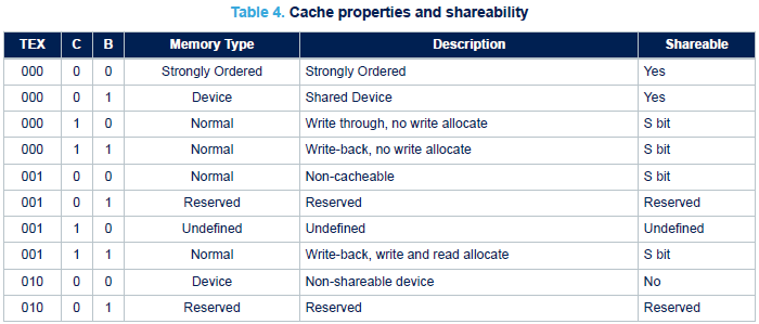

Based on the errata sheet, below is the recommended workaround for "2.1.1 Cortex®-M7 data corruption when using Data cache configured in write-through".
Workaround
There is no direct workaround for this erratum.
Where possible, Arm® recommends that you use the MPU to change the attributes on any write-through memory to write-back memory. If this is not possible, it might be necessary to disable the cache for sections of code that access write-through memory.
I have tried the 2 write-back configuration (row #4 and #8) in Table 4 of AN4838, but it does not help.
https://www.st.com/resource/en/application_note/dm00272912-managing-memory-protection-unit-in-stm32-mcus-stmicroelectronics.pdf
