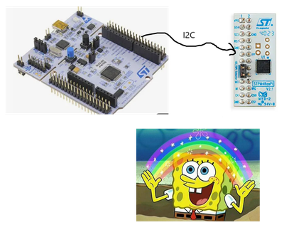

It seems there are not a lot of available evaluation boards or material for TPM running on microcontrolers
Probably because is overkill to use TPM for firmware updates and communications in a stm32G4
But this is a requirement i have received from upstairs.
My idea is to buy a stpm4raspiv21 or similar and wire it (i2c) to my nucleo board.
And WolfTPM as firmware package.
Does anyone have any advice for this? @Bubbles @na.1
