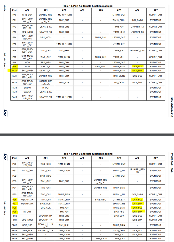

I am using an STM32G061K6T (only MCU I could find in stock at the time) and I'm try to communicate with an EEPROM via I2C.
I have the SCL and SDA mapped to PA9 and PA10, respectively with 3K3 Pull up resistors. SDA pin is pulled up and stays up however SCL is High when the MCU is held in reset but then it is pulled low and I don't know why. This happens with an EEPROM connected.
I have mapped SCL and SDA to PB6 and PB7 and this works and I can communicate with the EEPROM.
My questions are:
Why does it work when the pins are mapped differently - am I missing something in the datasheet ?
Why is the pin pulled low when the MCU is awake., despite the 3K3 pullup.
I have also checked for shorts
Any help would be apricated. Thanks, Mike

Hi all, I had the same problem and found that if CubeMX autogenerates the code then you'll need to add 'GPIO_InitStruct.Alternate = GPIO_AF6_I2C1;' to the GPIO pin struct definition in the 'HAL_I2C_MspInit' function. This is because if you use PA9 and PA10 as the i2c1 peripheral pins instead of the default pins PB6 and PB7 CubeMX doesn't add the alternate function definition to the struct mapping the pins. Hope that makes sense.

waclawek.jan
Which PA10/PA9?
What is the pulled-down voltage level at 3k3 and at 1k pullup (no need to swap resistor, I just need to know if it's significantly less than VDD * R/5k1)?
Double check the AF settings from the data sheet, different pins can have different AF mux values.
The Data Sheet and CubeMX are always 100% correct or agreement, but the odds of the DS being correct are bankable.
The pulled down voltage is literally 80mV and is 3.32V when held in reset
Mike
I have checked the Alternative functions and everything looks okay, at least to me
QSHAO.1
A statement of "Pins PA9/PA10 can be remapped in place of pins PA11/PA12 (default mapping), using SYSCFG_CFGR1 register" is in G0 datasheet. it may provide some clue to fix this issue?
