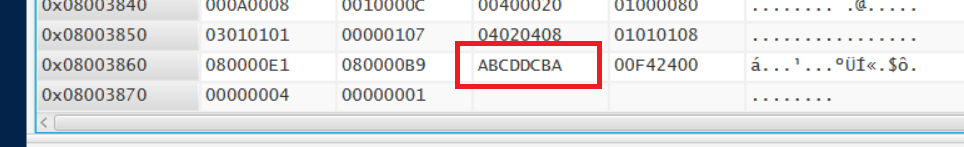

Stastny.Petr
I found a solution - I can use:
const uint32_t variable_X = 0xABCDDCBA;
But is it possible to say the compiler where should be this constant located? I do not need exact location, I only need to keep always the same the location in Flash when I make some pogram changes and recompile.
waclawek.jan
This is toolchain-dependent. If you use gcc-based toolchain, you should modify the linker script to include a custom section placed at a particular address, and then place the variable in question into that section.
I'm not sure whether there is some simple example out there, but this is a recurring question in this forum so you may want to search here.
