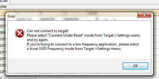

We also tried to program custom board by ST-Link-Utility tool.but wrong device detected message occurs and failed to program the custom board.

No device is detecting .Ref attached image .We also removed the jumpers cn4 on nucleo board to program custom board and as per shown image also change the connect under reset mode and make swd frequency to 480 KHz
