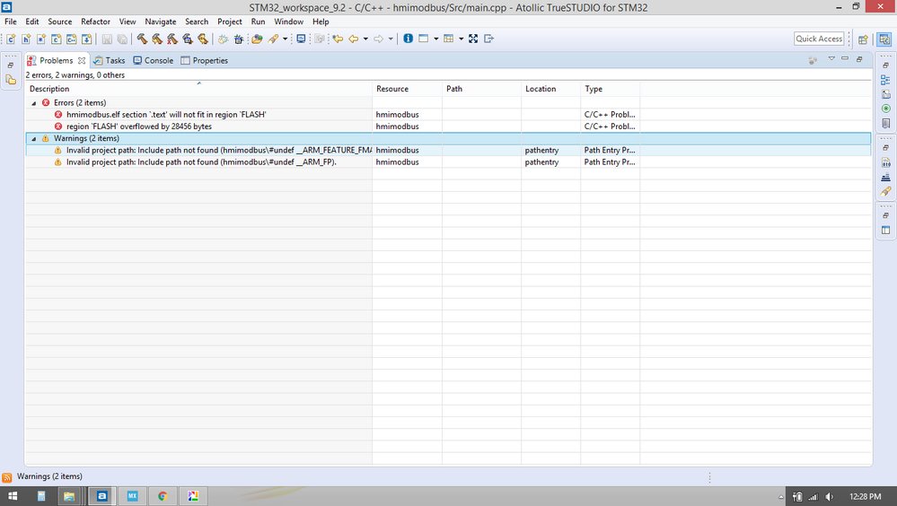

How to generate hex file in True Studio? not elf.
‎2019-01-09 10:59 PM
size of elf file and hex file is different for same code hex file size is small so in true studio use elf file thats why i get error
FLASH' overflowed by 156416 bytes C/C++ Problem
if both file generate then also gives same error so only HEX file not ELF.

Your problem is, that program + constant data are bigger than the FLASH in your mcu. This has nothing to do with the size of .elf - besides the resulting binary which goes into FLASH, .elf contains also debug information (and that often is much bigger than the binary). Chose an STM32 model with bigger FLASH, or rethink what needs to go to your program. Looking at the .map file might help to spot what is the biggest part consuming FLASH.
