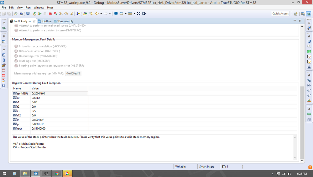

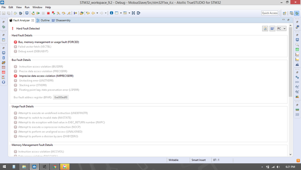

my application code running some time inside mcu then suddenly hard fault occur so i debug my application found hard fault occur inside mcu how to solve this.

Inspect the faulting code. There is likely a write instruction a few instructions earlier that is failing, thus the "imprecise" tag.
‎2019-10-05 4:06 PM
See this document: Cortex M3/M4,M7 Faults tutorial
‎2019-10-07 6:50 AM
problem solved i change interrupt priority high and low not same priority of both interrupt
