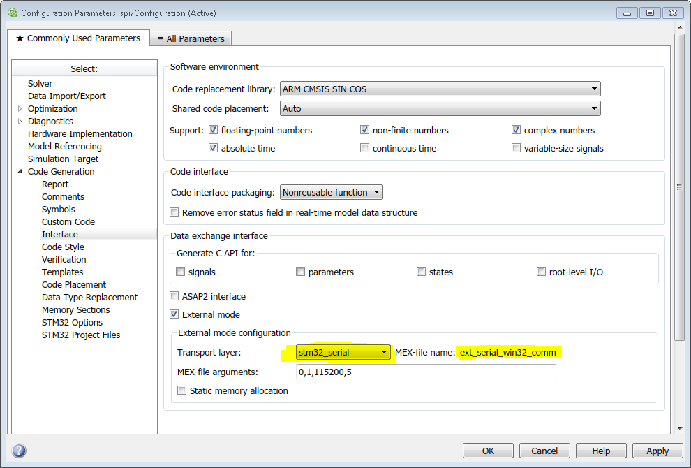

Sam Q.
Posted on November 16, 2017 at 09:49
Do you use USART as the communition? If so, please do check, wether the MEX-file name is ext_serial_win32_comm.
Although you selected USART as the communication while generating the code, but actually the MEX-file is still ext_comm, which means that TCP/IP will be used as communication. This bug will lead to the error when you try to connect to your target. According to your error report, your MEX-file is ext_comm.
By the way, youhave to enable USART that you want to use in CubeMX.
Best Regards,
XJ Q

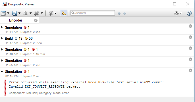

Posted on December 05, 2017 at 12:39
Hi guys,
Thanks for replying.
I used USART3 as the communication, since it's already connected to my STM32F429 board through ST Linker. ( I had test it in the past and working properly). Also, I enabled USART3 pins that I used in CubeMX.
Regardings the MEX-file,  I checked and it's, as XJ Q mentioned, ext_comm. So, when I modify it to
ext_serial_win32_comm (Just by clicking on stm32_serial tow times through transport layer options), the previous error cleared and another new error message occurred
I attached a snapshot for new error.
So do you have any solution.
Thank you again.
Abdulilah Alsulami
Posted on December 07, 2017 at 13:25
Hi guys,
I really appreciate you for helping me.
the error was eliminated and the model working properly in External mode.
I want to mention the bugs that I detect, and I hope the ST technical support to solve them very soon.
1. when you generate the code by the matlab and try to build the opened code by keil you will find error and this error because the value of Heap size. even if you had been changed the value of the Heap size (to 0x3000 according to MAT-target PDF) in CubeMx. you will find that it has not changed when check it again in your code.
so to fix this error you need to change it manually again in your code and Rebuild the code.
2. When you select stm32_serial for Transport layer, MEX-file name stay ext_comm. But this will cause the famous error, so you have to deselect stm32_serial and sellect it again to change the MEX-file name to ext_serial_win32_comm
