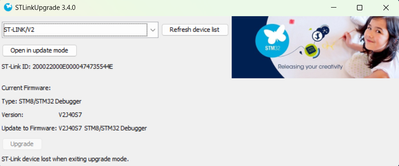

I've installed the usb drivers downloaded here but I still can't detect my STM32F103c6 board on the Device Manager on Windows 11. When trying to debug my first program on IAR I also got the error "Fatal error: Failed the search for probes, ensure that the USB drivers are installed. Session aborted!" and as I was searching on the internet it has to do with the lack of drivers. I also installed STM32CubeProgrammer as suggested in this forum and tried to update firmware but no device is shown on the "STLinkUpgrade" screen. So my question is do I need to install anything else? What am I missing? How do I make windows 11 detect my board? Thanks in advance.

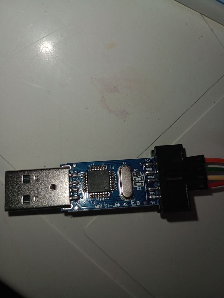

fabiotk
Yes (now there is, I wrongly assumed that the chip already comes shipped with a debugger since it has a USB cable but it doesnt). I bought a ST-LINK V2 and connected correctly the 3V,ground,SWCLK and SWDIO respectively. Now it appears on the device manager. However I'm still not able to do some live debugging. On the STM32Programmer I've got this error:
and in IAR when I click Download and Debug this error:
Sun Jun 25, 2023 09:56:06: : Fatal error: ST-Link, No MCU device found Session aborted!

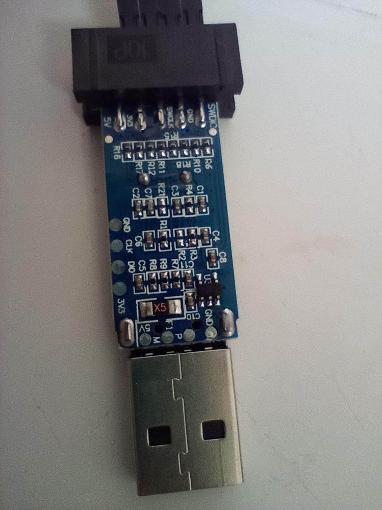

fabiotk
Photo of the st link v2 mini
fabiotk
This is an illegal clone of the ST-LINK/V2, its behaviour is unpredictable, which has also been discussed very often here in the community. I recommend you get an original ST-LINK/V2 and try again with it.
