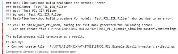

Call to stm32_make_rtw_hook error
BTrem
In my next try to run the "Test_PIL_IIR_Filter" example, I'm faced with an other error.
Does someone can help me on undersdanding and fixing this error?
Regards,
Bruno
3 REPLIES 3
Does the directory exist? Can you create such a file in the directory?
AV or other software preventing that from occurring?
@PascalR​
Yes, the directory exist.
The file ".extSettings" is generate during the build of the Simulink model.
For the last question, I don't know.
Bruno
Cyril FENARD
Hi @BTrem​ ,
This problem is not reproduced with the version 5.1.0 of STM32-MAT/TARGET, published end of July 2019.
While working on this version the followings tests were successful for PIL:
 - F429ZITx @ 180 Mhz, USART1: OK
 - L476RG  @ 80 Mhz, USART2: OK
Regards.
Cyril
