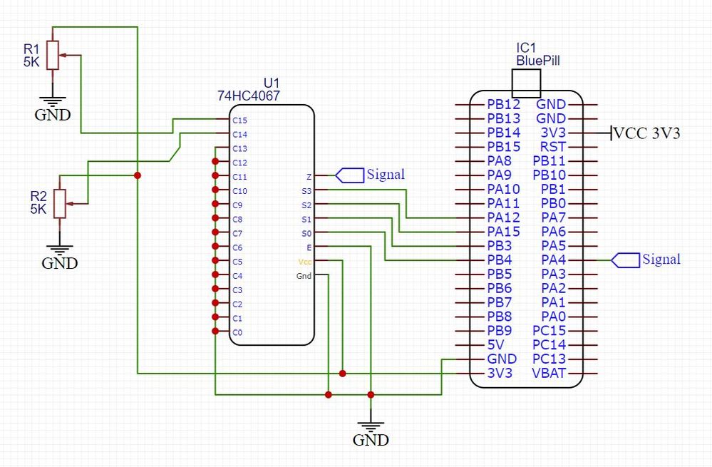

Hi everyone. I´d like to use a HC4067 mulitplexer to expand analog inputs on a bluepill. I´m using Arduino IDE to program the thing. But I can´t get reliable results. The values are jumping up and down or not reacting to input (potentiometer).
I´m wondering if using a HC4067 is restricted to certian pins?? I´m trying to use:
int s0 = PB4;
int s1 = PB3;
int s2 = PA15;
int s3 = PA12 ;
SIG = PA4;
I´m powering the HC4067 with 3.3 V and have grounded all inputs except input 1. I get fluctuating readings and POT on input 1 isn´t doing much, although I should see 0-4096.
Any help appreciated. Keep in mind ... newbie here. Or father with just occasional spare time trying to build an RC transmiiter for his son.
Before you ask: I use these pins because there are already other things going on on the board...NRF24 transmitter, Oled, etc.
This code is just a test setup.

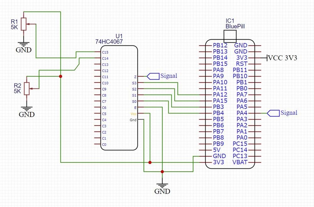

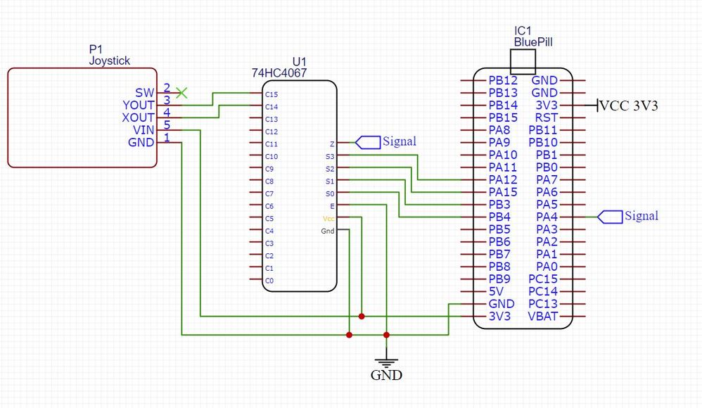

Could you share your wiring? maybe a paint drawing?
hit me up in https://www.linkedin.com/in/javiermu%C3%B1oz/
I´ve been using Atmels for years, although I never became realy good at coding. Its just a hobby. Those STMs are giving me headaches though. I had this Bluepill and a really strange Blackpill (strange pin layout) laying around for a while and now wanted to build an RC excavator remote for my son. An nrf24l will be taking away some of the analog inputs and I still need 8 analog pins (2 3-axis joysticks, 1 2 axis-joystick). That´s why I need to expand the ADC inputs. Alternatively I´ll revert to using a Mega (because of available memory for an Oled).
This one. Damn. Of course those pins aren´t floating. 0693W000008xBRSQA2.jpg
