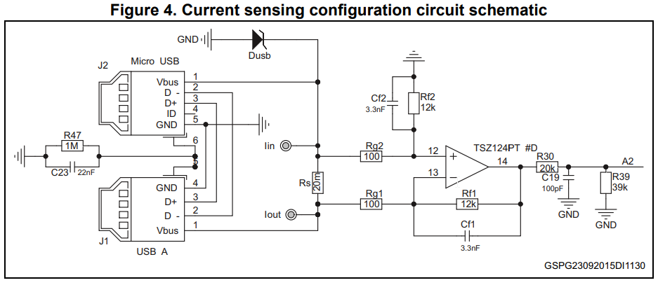

How do we increase the voltage obtained as a result of the current measured in x-nucleo ika-01a1
1 REPLY 1
Winfred LU
Refer to the current sensing configuration circuit schematic:
The output voltage of the operational amplifier is proportional to the measured current:
