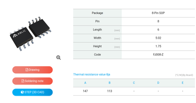

AScha.3
added to what @Peter BENSCH wrote,
just to give a number for a so-8 case :
https://www.ablic.com/en/semicon/package/archive/8-pin-sop-fj008-z/

Right, same case , same thermal values.
