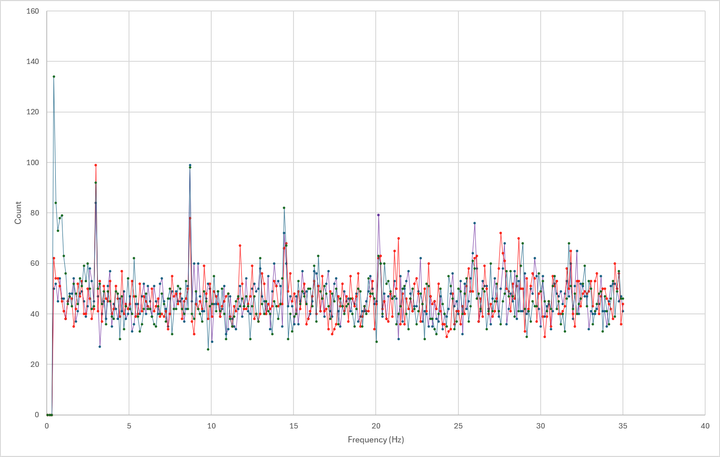

This is a comment it is not a question.
The older the mems sensor in acceleration the more likely it was to have a thermal effect below 1 Hz.  On the old CX1 from Sensr it was pronounced on three axes, on the MKI109 -210 combination it was reduced, now it is only just present on the Z axis.  This is a count of a couple of days of acceleration for the peaks below 35 Hz on a 16384 FFT at 1995 Hz.
To say the result is surprising is the understatement of the year.
The linear regression on the peaks spacing has a t Stat of 554, that is interesting.
less than 60 is Gaussian more than 60 is non-Gaussian.   From the Gaussian I can tell the temperature.
Nice little unit.
 CoefficientsStandard Errort StatP-valueLower 95%Upper 95%Lower 95.0%Upper 95.0%
Intercept-2.805330.040385-69.4642.57E-07-2.91746-2.69321-2.91746-2.69321
X Variable 15.7505710.01037554.53796.34E-115.721785.7793635.721785.779363
