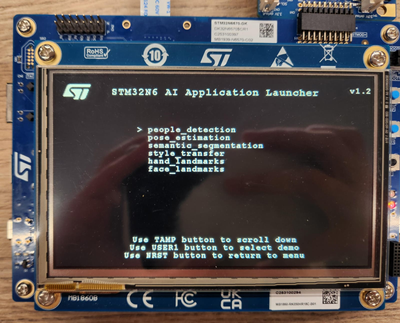

I'm working with the STM32N6570-DK board to deploy AI models. I've already learned the workflow for deploying a model on the board, but now I'd like to deploy multiple AI models and I'm not sure how to do that.
I ran one of the demos from the STM32N6 AI package:
 https://www.st.com/en/development-tools/stm32n6-ai.html
However, I don't have access to the source code, so I can't inspect the implementation details.

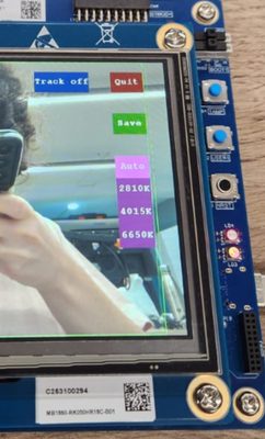

I would like to implement something similar to the application shown in the attached images. Specifically, I'd like to:
  • Deploy and switch between multiple AI models on the STM32N6570-DK.
  • Control camera parameters, such as white balance, in real time through the touch LCD interface.
  • Build a graphical menu that allows the user to select models and adjust camera settings directly from the screen.
Which files, modules, or software components should I modify to support multiple AI models and real-time camera parameter adjustment through the touch LCD?
