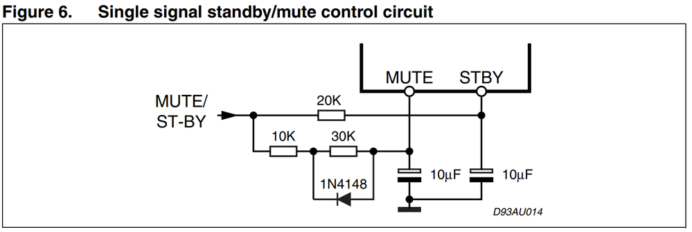

Dear Support Team,
I am planning to implement a circuit based on the TDA7293V. In this design, the IC will remain powered on, so I intend to use the circuit shown in Figure 6 (Single signal standby/mute control circuit) to prevent 'pop' noise. Given that my supply rails are ±44V (+Vs = +44V and -Vs = -44V), what is the recommended voltage range for the MUTE/ST-BY signal to ensure reliable operation?
Thanks in advance!! With warm regards, Daniel.

STBY and MUTE voltages of up to (+Vs)+|(-Vs)| can be applied, in your case 88V (referenced to Vs-) or 44V (referenced to GND).
However, since both inputs switch between a maximum of 1.5V (switch-on threshold) and a minimum of 3.5V (switch-off threshold), a control voltage referenced to Pin 1, typically GND, close to 0V is appropriate for the activated state and 4...5V for the deactivated state.
Does it answer your question?

Yes, that perfectly answers my question! Thank you very much for the clear explanation.
It is great to know that the pins can safely handle the high voltage if needed, but I will configure my voltage divider to provide around 4.7V to 5V for the deactivated state and 0V for the activated state, exactly as you recommended.
