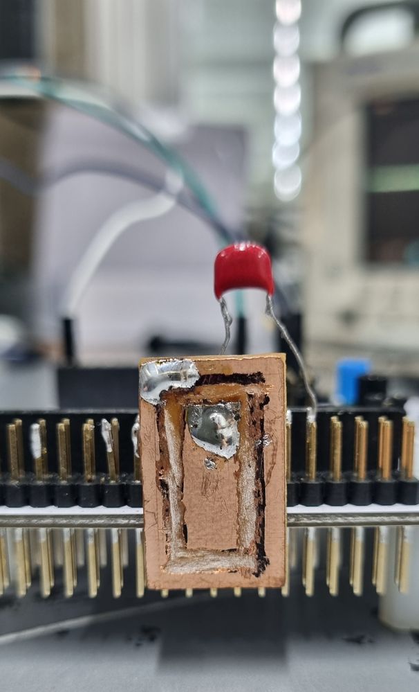

The first one shows the sensor shape. I've tried to connect the peripheral area of the sensor to the ground and to an active shield. The final result was the same.

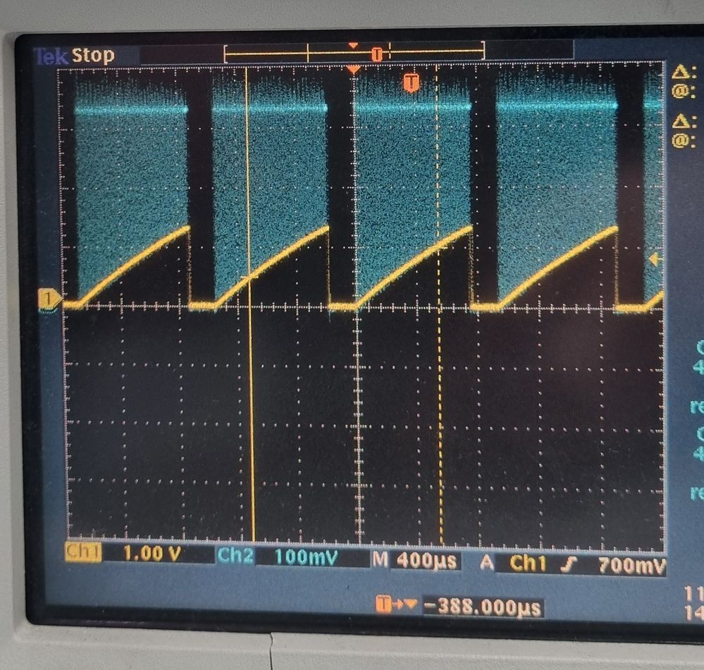

The second image shows the sample (in yellow) and the channel (in blue) waveforms. I am using a 15nF capacitor connected to the sample.

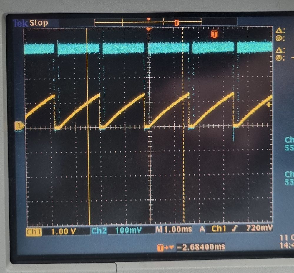

The last image shows the sample (in yellow) and the active shield (in blue) waveforms.
I am observing such behavior. When I bring my finger close to the sensor, the charging and discharging time of the channel input decreases, and I expected the opposite, since I am increasing the capacitance by bringing my finger closer.
For information, I am based on the STM8L152C6_Ex02 from the STM8L STMTouch Examples V1.1.0 library.
Please, I appreciate it if you could comment about the described bahavior and if the waveforms makes sense for you.

Thanks for the additional scope shots. The waveforms all look perfectly normal for the STMTouch charge‑transfer front‑end: clean, regular ramps and discharges, no obvious instability. That means the electronics and timing are essentially fine.
The fact that the curves hardly change between “liquid” and “no liquid” confirms my suspicion: the internal metal plates are capturing most of the field, so the sensor mainly sees metal, not the electrolyte. Library tuning won’t fix that.

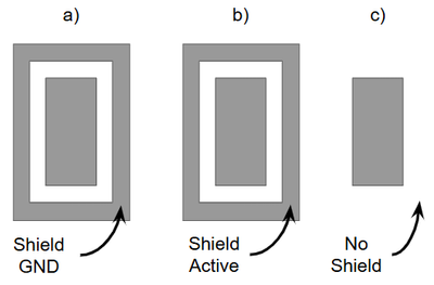

Having a second reference seems good, but do you suggest that one of the electrodes be outside the metallized area? If yes, unfortunately the metal plates occupy the entire internal area of ​​the battery.
About the electrode geometry, regardless of the method used for measurement, with one or two electrodes, which would be more efficient for my scenario?
a) with a GND shield;
b) with an active shield;
c) with no shield.

In your specific battery application the priority is to maximize the field lines that reach the electrolyte behind the internal metal plates. Any shield ring around the electrode - whether grounded (a) or active (b) - will intercept part of these field lines and therefore reduce your sensitivity to the liquid.
For that reason, option (c) no shield is the most efficient starting point: a single vertical strip electrode on the outside of the battery case, with no surrounding shield, placed where the liquid level changes.
Ground or active shields are useful to reduce environmental noise and hand effects, but only after you have confirmed that the bare electrode provides a detectable signal in the presence of the internal metal plates.
  • Keep each strip narrow rather than wide (e.g. a few mm), but long. Long strips give better resolution along the height
  • Make sure there is no ground copper nearby on the same side of the PCB, because it would short‑circuit field lines before they reach the battery interior
  • If you need noise immunity, put a ground or active shield only on the opposite side of the PCB, below the sensor traces, not around them on the battery side

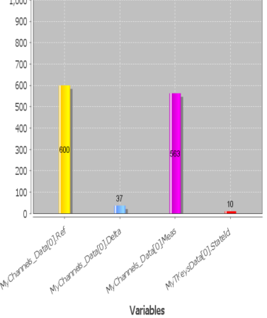

Hi Peter, I have tested it with a couple of electrode geometry, including your welcome latest suggestion, but with no improvements in the electrolyte detection.
I have the same Delta value with or without electrolyte inside the battery, like the image below.

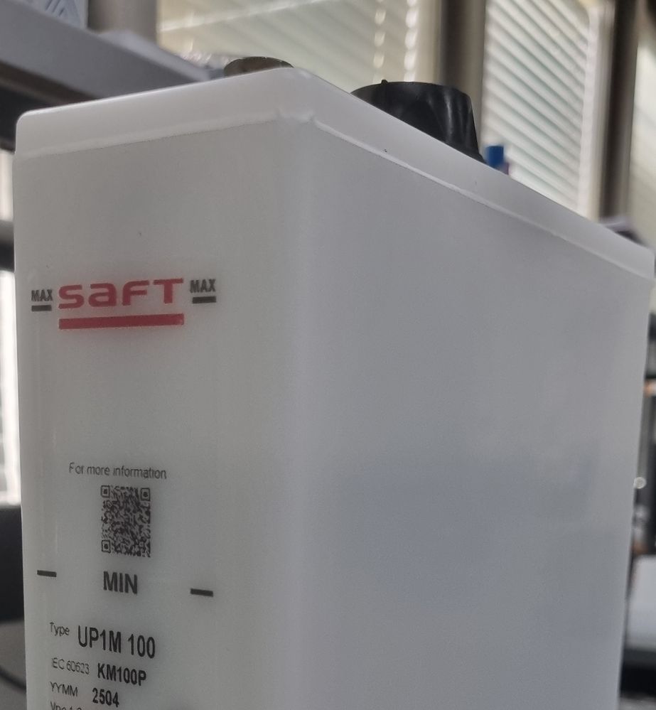

And just for your information, this is the battery type that I am talking about.

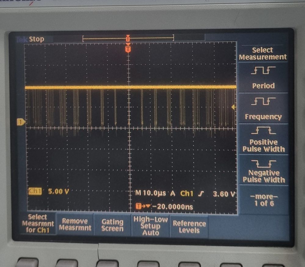

Also, I had the opportunity to test/explore a commercial fill level capacitive sensor. It uses the STM8L151G unit. I thought it was using the same STM8L touch-sensing library, but based on the waveform below I believe it uses a proprietary solution. The waveform was collected at the electrode point. It worked perfectly in all tested battery.

Now the picture becomes clearer, I should have asked earlier which liquid is present in your case.
It is apparently a battery with NiCd chemistry, probably with aqueous potassium hydroxide (KOH) as electrolyte, where a sensor principle designed for finger touches has reached its limits. The measurement result with the alternative product also shows that you should take a different approach - a true capacitive level sensor geometry instead of the touch library.
  • Implement a coaxial or parallel‑plate capacitor around the cell or along its side, fully insulated from the electrolyte (e.g. metal foil electrodes outside the plastics housing). The electrolyte then acts as a high‑k, lossy dielectric whose effective capacitance changes with level
  • Read this capacitance with a simple RC or LC time‑measurement circuit (timer capture/compare or charge‑discharge timing on the STM8L), not with the STM8L touch‑sensing firmware, which is tuned for fingers
  • Calibrate several level thresholds in software and add temperature compensation if needed
However, for your specific use case, I do not have a suitable, freely available library or a software recommendation. But perhaps one of the very friendly community members has already done something similar and is willing to share their knowledge.
