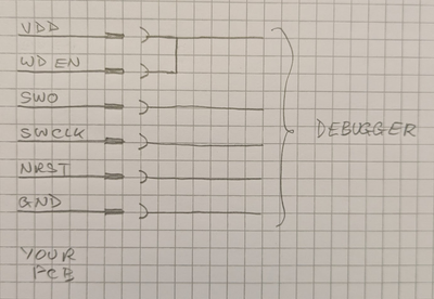

Which pin on the programming connector could I use? I tried using pin 15 on the J-Link—the ‘RESET’ pin—thinking it would hold the STM32’s nRST pin high while flashing the firmware, but it didn’t work.
You need to disable the WD.
You would need to make some custom arrangement in your debug connector to do that.
PS:
For example:
WD_EN pulls the WD /ENable pin high
