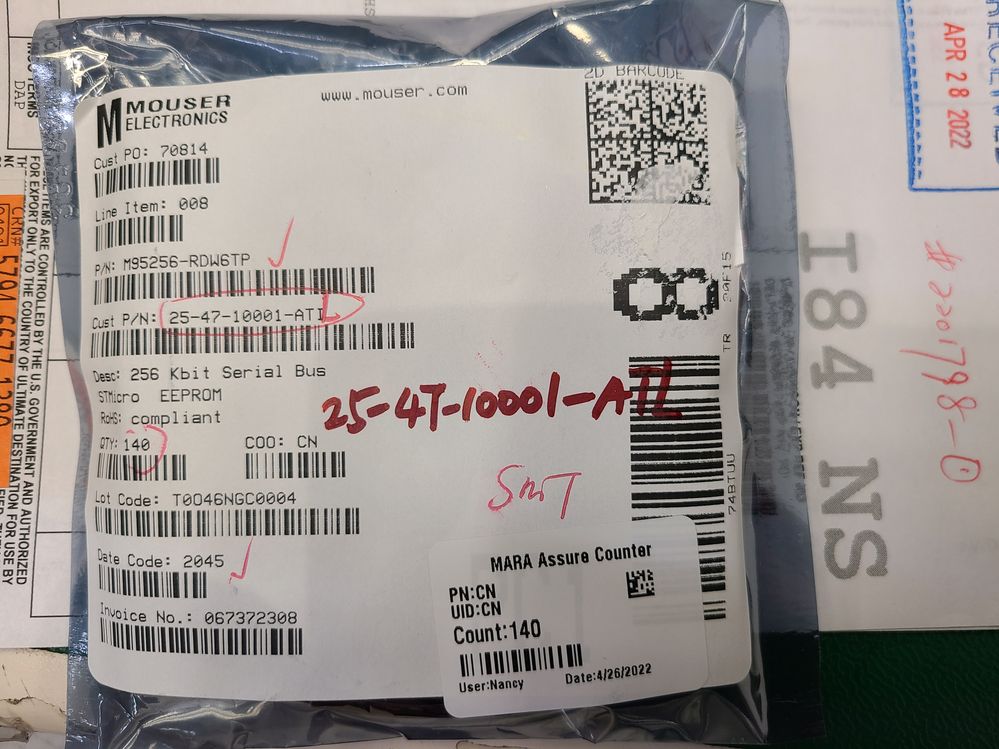

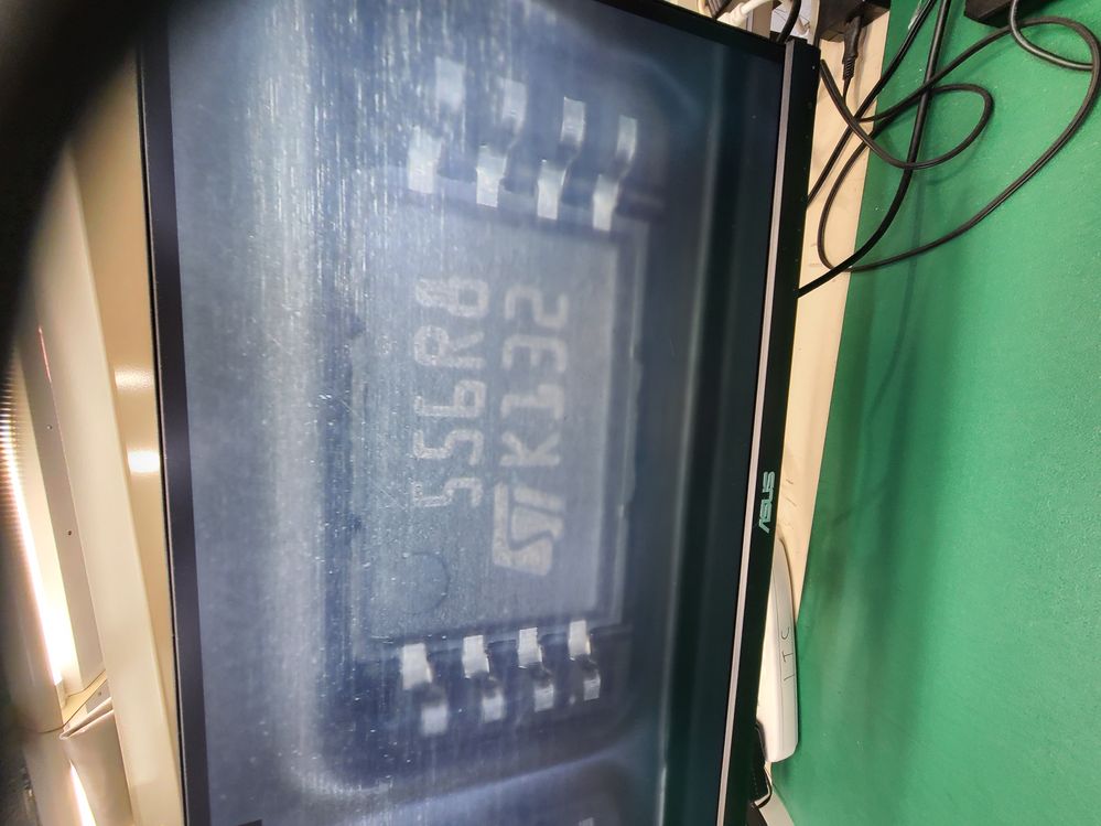

received some parts M95256-RDW6TP but body marking shows 556 we are trying to correlate if the right part was received. anywhere on website to locate info

Date code K132 is from ST & means manufactured in 2021, week 32.
Data code 2045 is from Mouser. --> I think you should ask them what it corresponds.

Seems consistent, any other letters? The Marking details have been poorly handled by the docs and this needs improving.

0693W00000LzVhqQAF.jpg0693W00000LzVhvQAF.jpgi have attached images

  • 556R8 is the correct marking for the ​M95256-RDW6TP
  • datecode on the device: 132 = YWW
  • datecode on the Mouser label: 2045 = does not match the dc of the device, needs to be clarified
