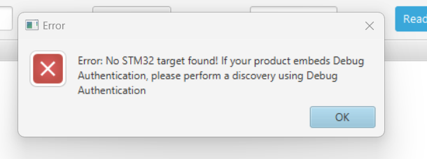

Thank you for your reply. Tried with CubeProgrammer. Still no luck. It throws below error and when the board is connected FAIL.txt is still generated.ST_error.png
"no target found" is just info: cannot connect...
So show, what CubeProgrammer shows...target voltage...etc.

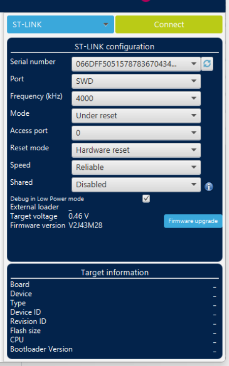

so:
Below is what the CubeProgrammer is showing. If i chose Reset mode as Software reset, then also after pressing connect it automatically changes to hardware reset.
Ok,
now we see : target voltage 0,46V . This cpu cannot work... :)

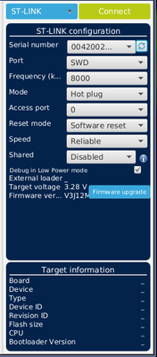

Give it some power , 3v3 ; then check again.

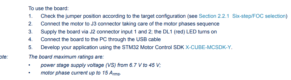

(Maybe check jumper settings on board, see manual. Or need connect power supply...)
ok. where exactly is this voltage? and where do i need to give power supply?
To the board...see manual:
Thanks for help. It worked. I was under impression that MCU is supplied by USB. However, it was clear once i checked schematic. Thanks again.
