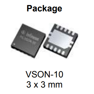

So, charge pump OR boot strap will work for such high current ?
‎2024-06-17 12:28 AM
Bootstrap will work; see a driver (i took one from mouser) like this : 2ED2778S01GXTMA1
160V max , 4/8 A drive , 30ns built in deadtime , bootstrap diode built in , about 2,50 €
- just a mini case, need good layout (!) pcb : VSON-10 , 3x3 mm !
read ds carefully, especially the "problems" , coming with stray inductance...
