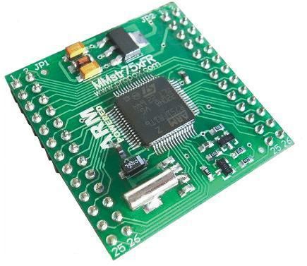

MMstr75xFR minimodule
* Complete, ready to use microprocessor system
* Fast ARM microcontroller STR751FR with up to 54 DMIPS throughput
* SerialFlash memory 64Mb (8MB)
* Reliable reset circuit
* Built-in system generator 8MHz
* Built-in 768kHz crystal resonator for RTC
* Built-in voltage regulator 3.3V 400mA
* Module supply voltage: 3.3V or 3.8 - 16V
* 2 x 26 terminals with 0.1'' (2.54mm) pitch fitting prototype board
* Small dimensions: 5mm x 5mm
* Available evaluation board and sample applications
STR751FR microcontroller
* 32-bit ARM7TDMI-S core
* 60 MHz, 54 DMIPS
* From 64 to 256kB in system programmable flash memory
* 16kB data flash memory
* 16kB SRAM memory
* 3 synchronizable timers each with up to 2 input captures and 2 output compare/PWMs
* 16-bit 6-channel synchronizable PWM timer
* 16-bit watchdog timers
* I2C interface
* 2 SSP interfaces (SPI or SSI) up to 16 Mb/s
* 3 HiSpeed UARTs with Modem/LIN capability
* 1 USB full-speed 12 Mb/s interface with 8configurable endpoint sizes
* Real Time Clock
* 10-bit, 3.75 us A/D converters (11-channel)
* Up to 38 I/Os
* Nested interrupt controller with 32 vectors
* Slow, WFI, Stop and Standby modes
* 4-to-8 MHz quartz oscillator
* Internal 5 MHz RC
* PLL for CPU clock
* 2.0 to 3.6 V application supply
* JTAG interfaces
