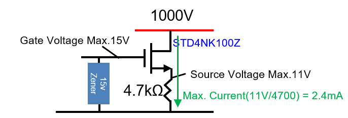

We use STD4NK100Z to operate in saturation mode using Source
Follower structure.
VG.MAX =15V (Zener Clamping)
VGS = 0 to 5 V
VDS = 1000 V
Source Resistor = 4.7k
IDS = Max 3mA (4.7k ohm resistance limits)
I have a few inquiries regarding this, so I specified it below. Thank you for your answer.
(1) Regarding the Super-Junction Type, I heard that there is a Local Heat Hotspot issue for the Linear Mode(Saturation) continuous operation. but The STD4NK100Z we use is a Planar Type, I know that there are very few Local Heat Hotspot issues compared to the Super-Junction. Is it correct?
(2) Even in the Hot-SOA area considering Thermal Unstable, if it is within the SOA area, there will be no problem with operation, right?
(3) Is there any document or link to refer to the difference in characteristics between Planar Type and Super-Junction Type? Please share it with us.

It is operating as shown in Answer 3, I understand that the source voltage follows the gate voltage and the source current is determined by the source voltage and resistance and that this current flows to the MOSFET drain-source Is it correct?
so Maximum source voltage is applied up to 11V. In this regard, we have confirmed that 3mA current flows to a maximum, not 125mA, so if 3mA flows to a maximum, is there any problem with operation? (By Thermal Hotspot, not Breakdown)
Circuit condition
Gate Voltgae Range : 5V ~ 15V
Source Voltage Ragne : 1V ~ 11V
Even if the gate voltage fluctuates, the VGS is uniform at about 4V (Source Follow)
Gate Voltage 15V
Source Voltage = 15V- Vth : 11V
Source Current = 11V/4700:2.34mA = MOSFET Drain-Source Current
MOSFET VDS : 989V​
Gate Voltage 5V
Source Voltage = 5V - Vth : 1V
Source Current = 1V/4700:0.02mA = MOSFET Drain-Source Current
MOSFET VDS : 999V
