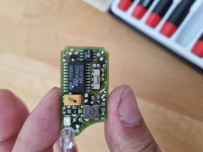

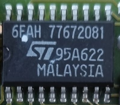

Hello ST community has any one an idea what this ST chip is as shown in the picture?
I haven't found any datasheet of this device.

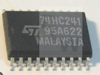

except the "customer numbering" , it looks like :
Could be an 74HC241 - or other ...

Provide some context, what type of board/equipment is this used on?
Looks to be a custom part, in which case no public documentation is available
This chip is Soldered on an old Mercedes infrared key PCB
So forget it, to get replacement; is probably programmed cpu , e.g.
STM8S103F3P6 .
It's probably a custom coded MCU, are you sure it is broken? Do you have another donor key fob?
The SOIC8 looks to be an EEPROM
I checked it with an other Board with the same parts.
