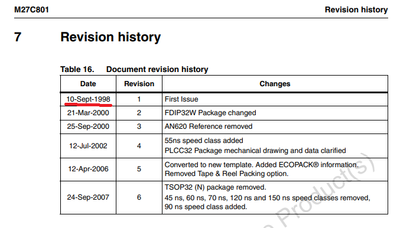

Question are: if that possible that very old ST chip manufactured in 1992?
I'm deducing the age of that part number from the datasheet first release date (I'm just speculating here). First release date is september 1998. So I suppose the device was born around that date.
@Perets wrote:
can be that from years2020?
No. That doesn't make sense.
