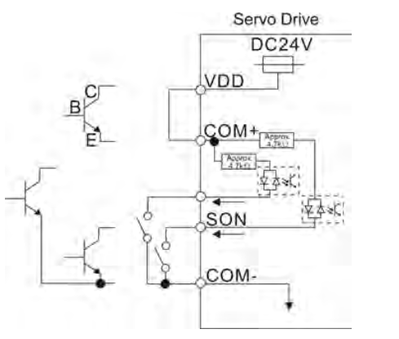

I buy a STM32F411 and on digital inputs I ll conect +24v sensors , on analogic input -10 to 10v sensor , on digital outputs ll go to driver +24v digital input , and analogic output I want deliver -10 +10v for control a motor driver ( I want this signal analogic not pwm wave) frequncy of project is less than 10khz
2024-03-19 11:26 AM
- which type of interface does the digital 24V sensor use?
- what type of driver is the one driving 24V outputs?
- what input impedance needs to be driven at the analog output?
2024-03-19 11:42 AM
on servo driver is 10k ohms for analog
4.7k ohms digital
Im using NPN 24v festo hall sensors
2024-03-19 12:48 PM

You will need matching circuits in any case:
- for the analogue outputs, a circuit based on an operational amplifier, for example, which generates the desired voltage of ±10V from the analogue signal from the STM32 (0...VDD). Depending on your requirements (accuracy, thermal stability, drift, etc.), you will find plenty of ideas if you use your favourite search engine while searching for "'+3.3V' +to +'+-10V'", e.g. this one. The analogue signal can either come from the DAC (if the selected STM32 has one) or from a PWM output with RC filter. Above I wrote of VDD in general, as the STM32 can be operated not only with 3.3V, but also with 2.5V, for example.
- If I have understood you correctly, you want to realise the digital outputs as npn at 24V. If you have no requirements for overload protection or similar, you can:
- use logic level MOSFETs whose gates are controlled by the GPIO of the STM32
- use npn BJTs whose base pin is controlled by the GPIO of the STM32 via a series resistor
- If the digital inputs have to be protected inputs, you can interface the NPN Hall sensors e.g. with CLT03-1SC3 (1 channel) or CLT03-2Q3 (2 channels, same data sheet) to get the 24V levels converted to the voltage expected by the GPIOs.
Hope that helps?
