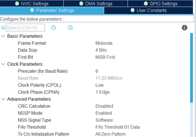

i'm Not Detected The RFID Card.
i'm Debug The Code then issue of Code in Highlighted Font.

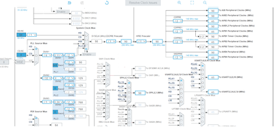

And My Clock Configuration Is has Below.
My Development Board Is STM32H7A3ZIT6Q.
How Can I Solve This Please Give The Solution??.
