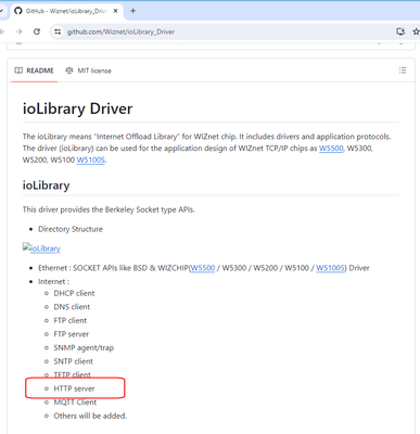

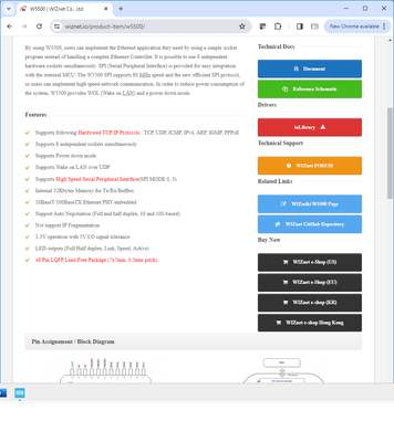

To learn how to use the Wiznet W5500, go to the Wiznet Product Page for the W5500:
Note the links to Technical Documentation, Drivers, and Support.
Following the 'ioLibrary' link:
thanks for replying! I'm using STM32CubeIDE. Do you know if there's an example available for this?
As @STTwo-32 mentioned, it's a 3rd-party library - so you'd have to ask that 3rd party for support.

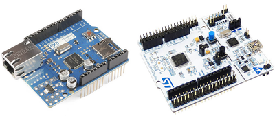

Here's an example using a Nucleo-F103RB board and an Arduino WS5100 shield:
https://www.carminenoviello.com/2015/08/28/adding-ethernet-connectivity-stm32-nucleo/
It's using plain Eclipse rather than the STM32CubeIDE - but that should be close enough to get you going...
It uses the Wiznet ioLibrary - mentioned earlier - which also supports your WS5500...
