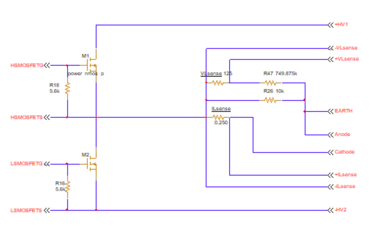

I have designed a high voltage switching circuit using a half-bridge topology which employs the SCT1000N170 SiC MOSFETS as the power switches. The aim is to apply the design as a pulsed-dc power supply for driving a magnetron sputtering gun. Two of UCC5390 single-channel Isolated gate drivers are used for driving the gate of the switches. The diving signals are generated from a microcontroller (Arduino due).
The schematic of the half-bridge part is attached as figure 1. Based on a SPICE simulation (PSpice-For-Ti), the design appears to work fine. However, when implemented onto a pcb (2-sided, conventional lead soldering of parts), there is a major problem. The pulsed-dc voltages across a resistive load exhibits a slow decay at the end of a positive pulse, and a slow build-up at the end of a negative pulse, see figure 2. The curves occur in off-time durations, i.e. when the gate drive signals of both switches are LOW. The rails HV were +- 150 VDC. Further investigation using the SPICE simulator suggests that the decaying and build-up curves are likely to be the results of the discharge and charge, respectively, of a parasitic or stary capacitances present across the drain and source terminals of the switches. The magnitude of the capacitance is about 1000-2000 pF, which is about two order-of-magnitude higher than the specified COSS of the SCT1000N170.
What are the possible sources of these apparent parasitic or stary capacitances? Advice and suggestions to eliminate them are greatly appreciated.
