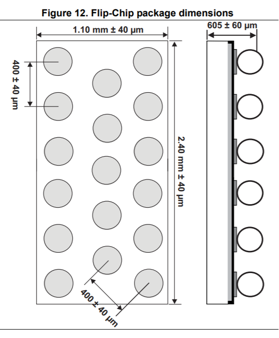

Hi, could you confirm that the EMIF06-HSD03F3 footprint has bga pads that are all 0.4mm from each other? The datasheet drawing of the footprint is a bit misleading and has the pads asymmetrical, but it looks like from the dimensions that it is symetrical.

Hello Dave,
I confirm that EMIF06-HSD03F3 has bump pads that are all 0.4mm from each other as shown in figure 12 of its datasheet and reproduced below.
I hope this answers your question.

Dave Kearney
Thanks, do you think it would make sense to redraw the above figure then? The pads are clearly not all the same distance apart on the drawing - the middle column of pads is noticeably closer to the right than the left on both drawings in the datasheet - so it is a bit confusing.
Cheers,
Dave
DSass.1
Just to make sure : Bump side = bottom side?
Thanks
Dori
Mohamed S.
Yes, bump side is bottom side.
