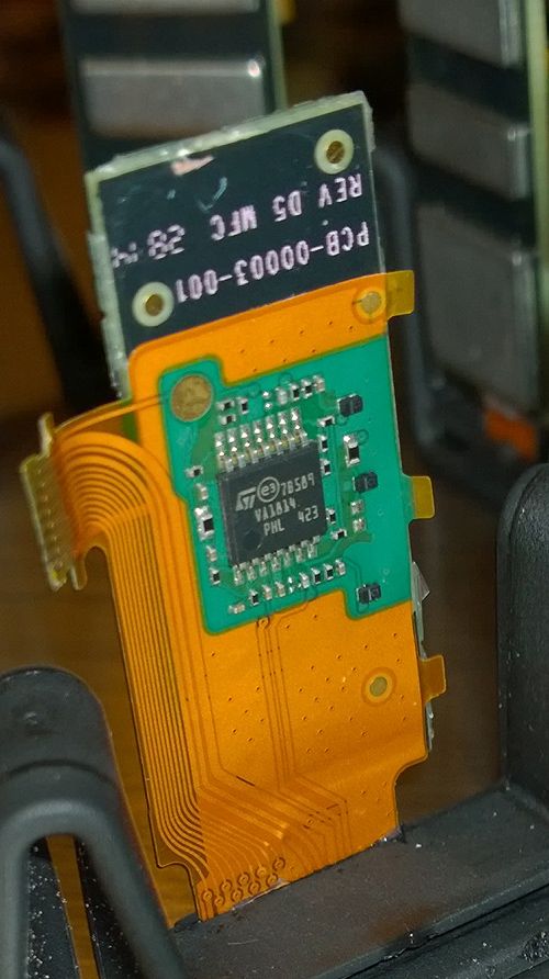

Help identifying quad OP Amp
CTack.2
0693W00000FDiFkQAL.jpgSee picture above for exact markings. No markings on the bottom of the IC.
Battery powered device (low voltage)
Markings:
ST (e3) 7B589
VA1814
PHL 423
Alternate version has similar markings. Maybe just a date code change?
ST (e3) 7B474
VA1814
PHL 423
Well, it's already published, just not where you expected it to be. As already stated, it is instead labelled on the box/packaging in which it is delivered.
Anyway - yes, I'm 100% sure VA1814 is the marking for TSZ124IPT.
Regards
/Peter

My money is an ST second-source/equivalent to the LT1814
https://www.analog.com/media/en/technical-documentation/data-sheets/18134fa.pdf
Peter BENSCH
@Community member​ is not completely right, it is the TSZ124IPT with marking VA1814.
Regards
/Peter

@Peter BENSCH​ Why does this chip have that marking? I don't see any reference to that marking in the datasheet you linked. Is it maybe an older marking?

The information is usually on the packaging unit that is used to manufacture a system.
The marking scheme is not always mentioned in the datasheet, but STMicroelectronics is always happy to help if someone needs help with a reverse search.
Good luck!
If the problem is resolved, please mark this topic as answered by selecting Select as best for the favourite answer. This will help other users find that answer faster.
/Peter
So, you're saying that the markings I'm seeing, while not published, match some internal documentation that gives you confidence that these are actually TSZ124IPT parts?
Regards
/Peter
