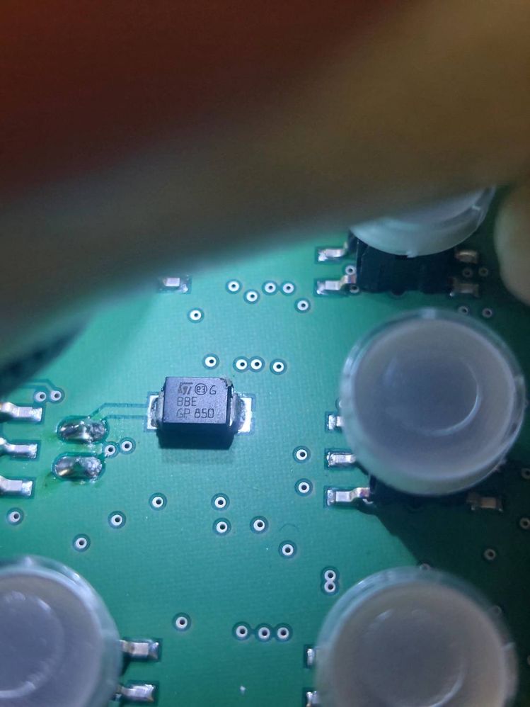

GP850 DATASHEET
EricChen
SMBJ12CA, 600 W TVS in SMB
https://www.st.com/resource/en/datasheet/smbj58ca.pdf
