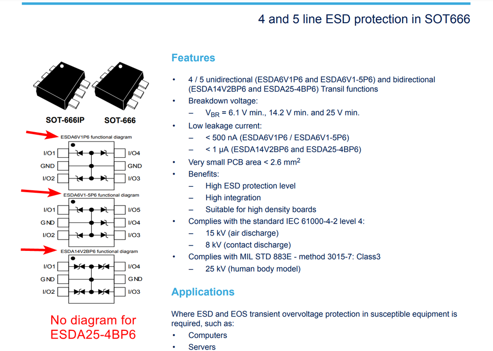

The datasheet for the ESDA25-4BP6 is a superset datasheet that covers 4 part numbers. The datasheet contains functional diagrams for 3 of the 4 parts, but no diagram for the ESDA25-4BP6. I am guessing that the ESDA25-4BP6 has the same pinout and configuration as the ESDA14V2BP6, but don't like to take guesses at these sorts of things. Could someone please confirm that the ESDA25-4BP6 is indeed configured the same as the ESDA14V2BP6?
Thanks,
Neal

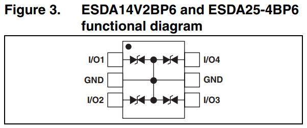

Thank you Tesla DeLorean. May I ask where you grabbed that image from? I didn't see it in the datasheet.
2024-12-06 5:19 PM
Attached PDF, front page, lower right
