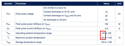

My system is required to operate at -40C.
The datasheet states that low range ambient temperature is -30C, while the junction temperature is -40C.
Can you please explain the discrepancy between the two? Under what conditions can the junction temperature be lower than the ambient temperature?
Can I use the ECMF02-4CMX8 in my case?
Thank you in advance.
FGUIT
The ECMF02-4CMX8 can be used at -40°C.
Datasheet will be modified with Top between -40°C and +85°C.
Best regards.
Fabrice.
If you want to remain within the allowable limits of the datasheet, no this doesn't work. It's a bit odd, but that's what the DS says and we have no reason to distrust it. It's also on rev 4.

Hi TDK,
It would still be helpful to understand the reason for the -30C limit, since as you mentioned, it is a bit odd.
Does the -40C junction temperature refer to the TVS diodes while the -30C is limited by the common mode filter?
FGUIT
