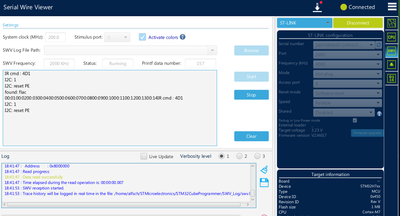

You can connect with the CubeProgrammer -> ST-link -> to the ITM :  then see SWV  -> SWO output:

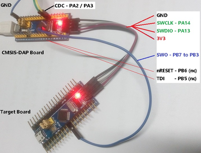

>Do (any) STM32 support that ?
Yes.  On the "clone" ST-link V2 just need to connect to PB7 , UART1 Rx , to get the SWO data.
(The pic i showed, with CubeProgrammer connected to a H743 cpu showing SWV data, is made with an modified
ST-link V2 , working 100% reliably at 2 Mbit. With a ST-link V3 higher speed is no problem.)
here with cmsis-DAP , also STM32F103 cpu :

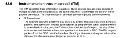

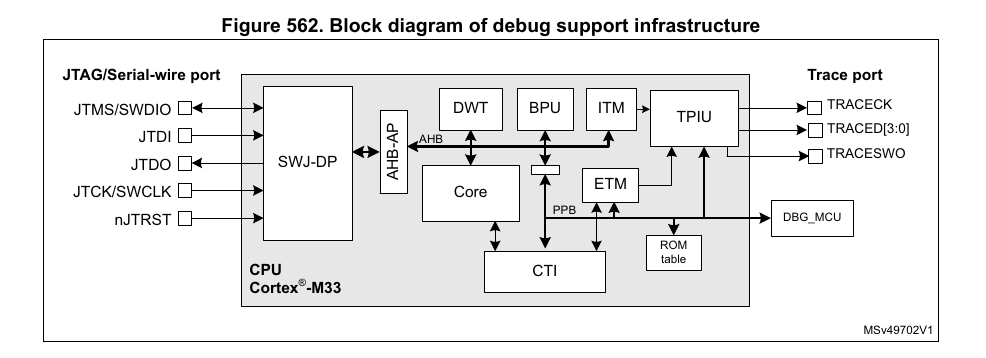

Ok, thank you all indeed, that is help for me that I am on the right way...
1. I have chinese clone "blue pill" that have "normal" stm32f103c8t6, CubeIDE program it normal and simple example - led is blinking. Yes I have another one, fake, not working.
2. SWO output can work in 2 protocol: It transmits data as either UART (NRZ) or Manchester code,. By default, it works at 2Mb/s speed.
3. SWD with SWO output has more benefits than UART debug message, less load to MCU, only 1 wire use. If my result will not be success, noway - only UART message :(
4. stm32 cortex M3,M4 support SWD SWO. But I dont undestand all of:
UART encoding
This protocol is supported if bit [11] of the Device ID Register, 0xFC8, is set. It is enabled when bits [1:0] of the Selected Pin Protocol Register, 0x00C, are set to 2'b10. Data is sent out in packets of ten bits, with start and stop bits, as shown in Figure 11.11 and Table 11.12. Capture devices are expected to operate at the same clocking speed as the TRACESWO pin and synchronize by waiting for a start bit.
Somewhere I read, SWO not activated by default. A some register need to be init ???
5. Yes, on the "clone" ST-link V2 it is possible solder + 1 wire to PB3 and send ITM_sendchar() message to window "SWV ITM Data Console" in CubeIDE. In my case, capture SWO data should be read by another device (something like "display terminal" read-only).
Maybe I need to read the official datasheet of the debug SWD (SWO), configuration registers, etc. Can anyone help me find something? Thanks in advance.
