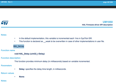

The clue is in the names - they provide inline delays:
Note that all the HAL functions are also documented in comments in the source code:
  * @brief This function provides accurate delay (in milliseconds) based
  *        on variable incremented.
  * @note In the default implementation , SysTick timer is the source of time base.
  *       It is used to generate interrupts at regular time intervals where uwTick
  *       is incremented.
  * @note ThiS function is declared as __weak to be overwritten in case of other
  *       implementations in user file.
  * @PAram Delay specifies the delay time length, in milliseconds.
  * @retval None
__weak void HAL_Delay(uint32_t Delay)
