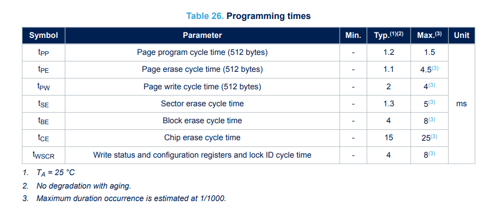

While calculating the energy consumed in M95P32I. We need to calculate the time duration it is going to write and read the data. As mentioned in the datasheet few " ms " is given as shown in the table given below.
0693W00000Y8JGyQAN.pngSo, is there any way to calculate the approximate time to write and read the data.
Pierre P.
you can follow the typical values in table 26. They are extracted from product characterization (all range of temp/Vcc)
ADuiv.1
In certain case, for example consider we are going to read and write 50 Bytes of data.
what will be the read and write time for EEPROM(M95P32I)?
