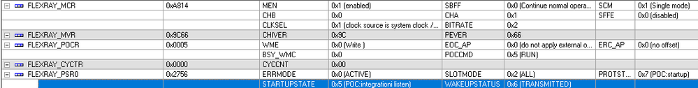

Hello community,
I am asking myself if there is actually anyone running FlexRay on the SPC56EL70L5 Board?
I am currently stuck in the wakeup process (I think that is where I am stuck), because the wakeup pattern does not get send. Does anyone have any experience with that?
Thanks in advance.

Hello David,
1.)
Node B should be
integration_listen
state just like you said. I think you left the part in your code for Node B which set the controller into POC:allow coldstart.

If I dont include the allow_coldstart part the POC ends in the
integration_listen state:
2.)
Could that be that the
FID and HCRC are from different frames sent by different nodes? You should try to configure to usethe keyslot as a startup / sync frame so you know what do you need to see on the scope.

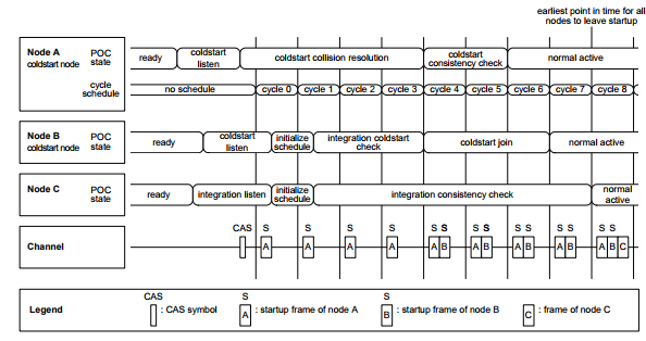

Accordint to the specification: A TT-L coldstart node always finishes the startup after six cycles. What I still dont know how the controller knows that he is a TT-D or a TT-L coldstart node. I think the reason that your Noda A does not stop transmitting his sync frames is because he think that he is a TT-D cs node. Here is the image of the TT-D coldstart startup:
I will give you an update if I find anything out.

At this point I am a little bit clueless what TT-L or TT-D means and I cannot find anything in the specification.
But I have seen this timing diagram - that is why I am a little bit confused because I am not reaching those states plus I think that some of those startes cannot be seen on the debugger because they happen 'so fast'.

  • The startup needs at least two coldstart nodes, one leading and one following. The following coldstart node should be able to see that the coldstart process has been started on the channel. (maybe delay a bit the transition to the startup state on the following node should work?) The following node should end in the Coldstart Join state before reaching the normal active state

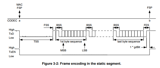

  • The two nodes need to have different key slot IDs obviously so they would not be transmitted in the same slot. Keep in mind that what you see on the scope is containing the coding sequences (TSS, FSS, BSS), so if you want to decode the frame segments exclude those.0690X00000607fbQAA.png
