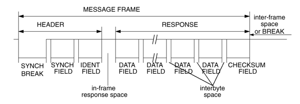

we are currently working on a LIN-Slave Driver for the SPC560D40L1. The use of the hardware-id-filter have made it easy so far but now we fail in one last test where we must distinguish whether the framing error has occurred in the header or in the response.
Is there a way to distinguish these two events in the framing error interrupt with id-filtering activated?

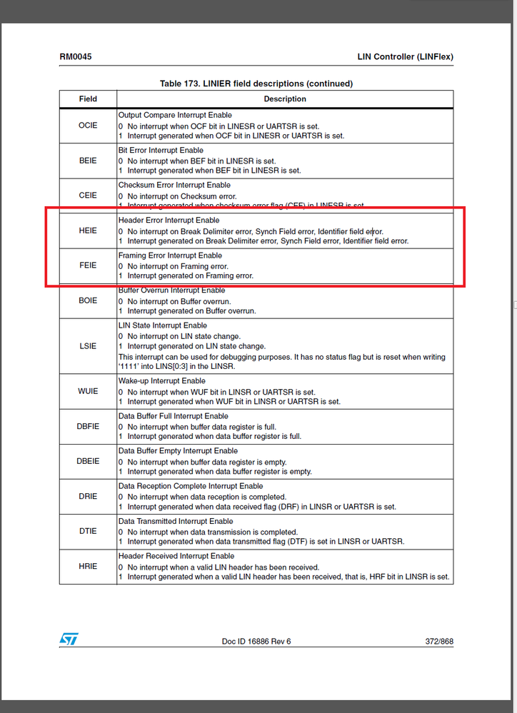

Hello Torben,
Yes you can.
in the chapter 20 from the RM0045
   Best regards
                     Erwan

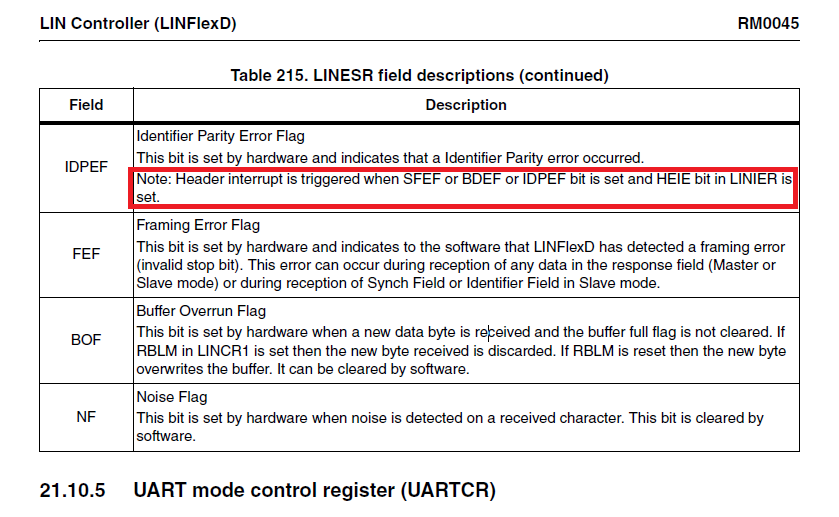

We have noticed the header error enable flag as well but we can't find the corresponding flag, like mentioned here:
Best Regards
Torben
Posted on January 12, 2017 at 16:13
Hello Torben ,
the RM is not clear.
maybe , the Header error Interrupt is triggered in IDPEF Flag for SPC560Dxx Family
Could you try this ?
    Best Regards
                     Erwan

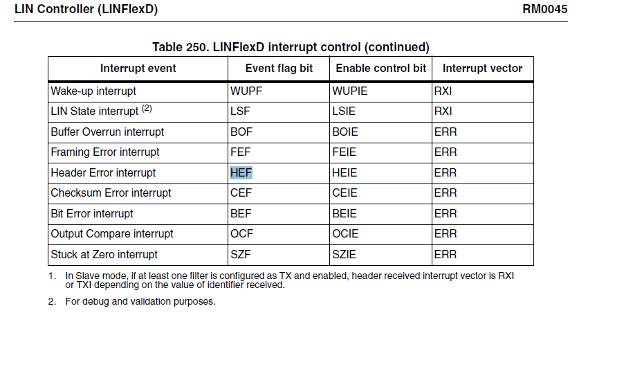

Posted on January 13, 2017 at 09:49
Hello Torben ,
After checking with experts ,
For header Error Interrupt, you need to check the flag SFEF , BDEF and IDPEF
For Framing Error Interrupt, you need to check the flag FEF
      Best Regards
            Erwan

Posted on January 16, 2017 at 14:10
Hello Erwan,
we tried your suggestion but we still couldn't find out if a framing error has occurred in the identifier of the header or in one of the data bytes of the response.

Posted on January 17, 2017 at 10:37
Hello Erwan,
yes, we checked it.
It seems like the IDPEF flag, for example,  is only for parity errors and is not related to a framing errror.
Parity errors must be handled differently according to the LIN spec.
Best Regards,
Torben
Erwan YVIN
Posted on January 18, 2017 at 16:43
According to the RM ,
FEF is the flag relative to Framing Error.
SFEF or BDEF or IDPEF bit is the flag relative to Header Error.
Did you check the others flags ?
   BR
                 Erwan
