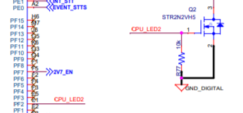

0693W00000FCK1SQAX.pngThe green LED can be simply managed toggling the proper GPIO (e.g. the PF2 for the green led), as shown in the schematic below.

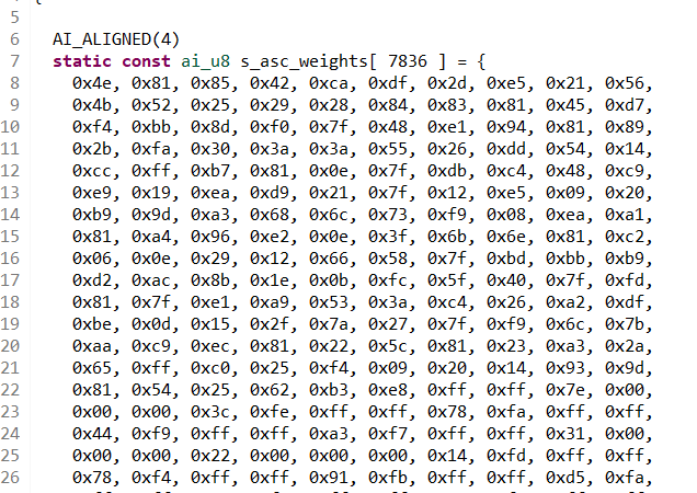

I face a very similar challenge: the asc_data.c holds the inference matrix, e.g.
How can I generate an inference that suits the same release used in FP-AI-SENSING1 ?
