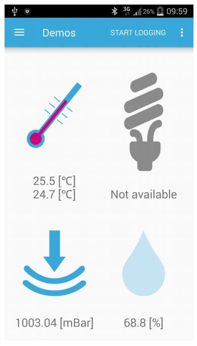

STBLESensor is the general application, available for Android and iOS, for testing ST sensors with your smartphone and for logging the data exported by a BLE device using the BlueST protocol.
The app shows different panels based on the data types exported by the firmware, including:
  • Environmental data;
  • MEMS sensor fusion data and plot;
  • activity recognition;
  • BlueVoice and speech to text;
  • beamforming;
  • sound source localization;
  • pedometer;
  • cloud logging.
Depending on the specific FW, wich will be detailed in another post, the application can also show a serial console to exchange string messages with the board. This functionality is also used to upgrade the board firmware.
