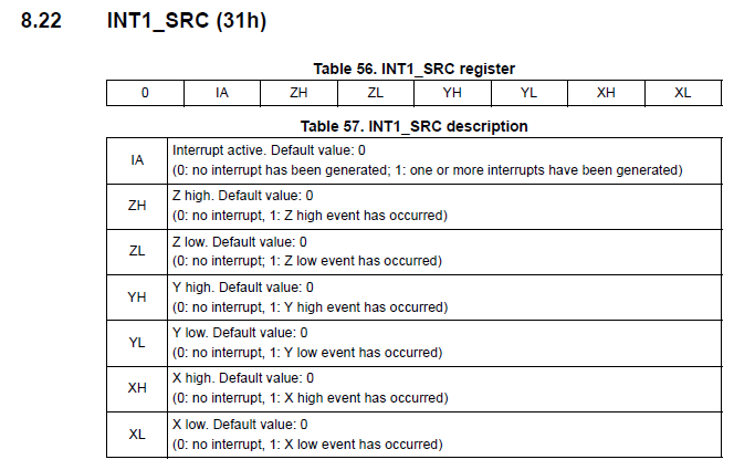

Why in the INTx_SRC register of LIS3Dx, there is XH/YH/ZH and XL/YL/ZL, but there is only one THS register
Kefei Yao
Posted on March 14, 2018 at 07:40
In the INT1_SRC register, there is XH/YH/ZH as well as XL/YL/ZL bits to indicate the (XYZ)H/L event has occurred. But there is only INT1_THS register instead of INT1_THS_HIGH/INT1_THS_LOW. How can I configure two threshold for each axis?

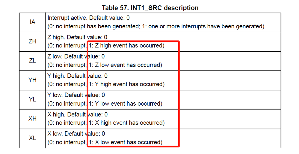

Posted on March 16, 2018 at 08:10
Yes, I understand the threshold is common for XYZ. Probably I have some misunderstanding of those register bits. In the datasheet, it says ZH/L goes 1 when Z high/low event has occurred. What does Z high/low event stand for. What's their relationship with the
INT1_THS
  register  or any other relevant register?

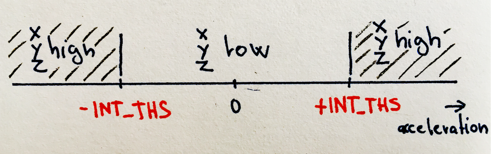

Posted on March 16, 2018 at 10:38
I hope my picture will make it clear.
Posted on March 19, 2018 at 03:17
Thanks for the reply and nice picture. So when the acceleration is in XYZ high area in the picture, the high event is 1, and low event is zero. And vise versa. High and low event can't happen at same time.
So it is register design matter that it uses two separate register to indicate high/low event instead of one. Correct?
Posted on March 19, 2018 at 09:30
Yes, your understanding is correct.
