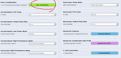

Hi Federica Bossi,
I configurated reg using easy Configuration in the Unico-GUI tool

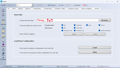

and I started the IMU sensor and started saving data
then I loaded the data from the Data Patterns of the MLC Part and this result comes out.
Thank you
Federica Bossi

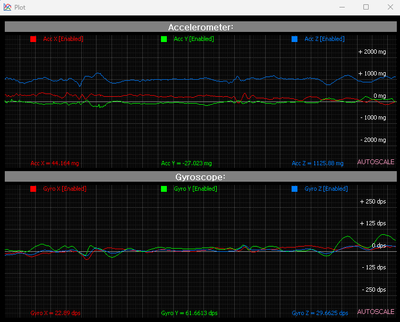

Hi @sygo ,
It seems all correct. Can you try, after the easy configuration, to click on START (on the top, near disconnect) and then plot (on the left) ? Are the gyro outputs plotted?
sygo
Hi Federica Bossi,
The gyroscope works fine.
Still weird when I save and load again
However, if i just turn up the acceleration, angular rate, and temperature, it comes out fine. Why does it work like this?
